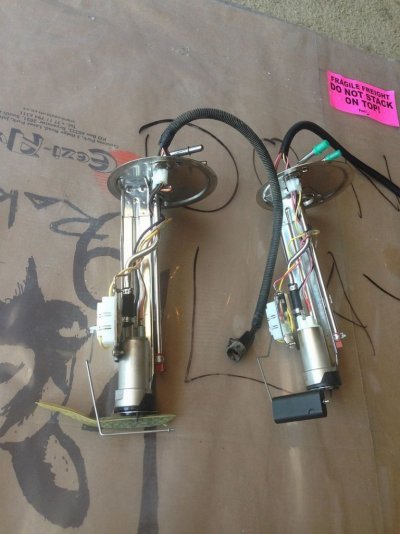

The bad news is the sender isn't a part that can be purchased separately. It is part of the hanger assembly which also includes the fuel pump. If you have anything over 100000 miles on the expy then it would be best to replace the assembly. Make sure that you try to get the tank as close to empty as possible before dropping the tank
