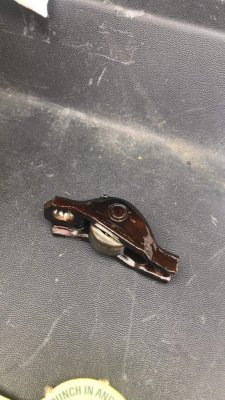

67F0AA30-6093-4A76-9605-21E869189B95.jpeg Just wanted to update on this. After deciding to just do the phaser on the affected bank, I pulled the valve cover (which I asked the mechanic to do for me and he wouldn’t) and found what I though could have been the culprit. It chewed up and spit out the exhaust rocker on #8 which is why it was acting like a clogged exhaust not a timing issue. Returned the phaser since they really aren’t that noisy and replaced the rocker. It will need a cam since it was a bit rough, but not horrid. I will save that for when I do the full “bulletproofing”.
Thing runs great now. Got a steal of a deal on it, and its the vehicle I wanted.
