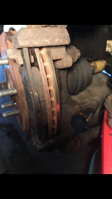

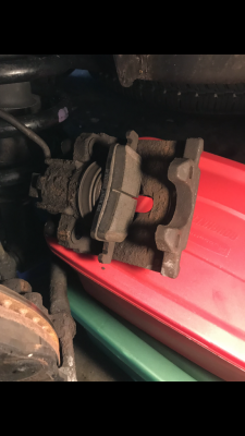

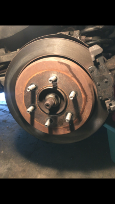

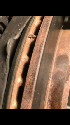

My 2003 expedition just recently started making these noises ONLY when I’m braking. It sounds like it’s coming from underneath but towards the rear not 100% because I’m driving and can’t see directly. Talk to a few people said it’s prolly the brake pads worn or rotors. I said def could be because it’s been over 5 years since I changed the rear ones. I just changed the front ones in August 2017 and do so more often. I’m clearly no expert but I took the wheel and caliper off and quite honestly I think the brake pads and rotors don’t seem in dire need, to me anyway, so any suggestions on what this could be? I dont want to drive it because it can’t be good but it’s my only car so I’m in a time crunch. This is the only wheel I’ve check though so far (driver side rear) see pictures below.

Those rear pads don't look at all worn to me. Are they doing anything when you brake?
After you drive around and brake, are all 4 rotors shiny from braking? The pads look brand new to me which is odd after 5 years but how many miles are on them? Is the other wheel pretty much exactly the same? My favorite trick is to drive around braking hard for a while then read the temperature of each rotor with an infrared thermometer. I've found inconsistencies which indicate problems to be fixed.
I changed front rotors & pads at 75K miles, then front & rear rotors and pads at 125K, then front rear rotors and pads again at 160K (Rear still ok but changed anyway). Rear pads wear slower than front on my 03 but they do wear, and the wear should be fairly even across all 4 pads or something is wrong IMHO.

You should also pull the rear rotors (ouch!) and see if the parking break parts are rusted apart and bouncing around in there. Try stopping the car with just the parking brake, but be prepared for them not releasing if you haven't used them in fifteen years. I've seen many that were neglected toast and their rusty remnants knock around in their drums. When you pick up speed, the centrifugal force makes the loose parts, lining chunks and rust stop clanging -- slow down and they knock around again.

I’m going from memory here...isn’t there supposed to be a removable clip that the ears on the brake pad fit into on the caliper? It creates a track for the pad to travel on while brakes are being applied. I don’t see any in the pictures so wonder if the pad may be vibrating from the slop the missing clip may create. Again, it’s been a while since I’ve had to do my rear brakes so I’m not positive there are any that go there.

The inside outer edge of the rotor appears to have been rubbing on something. I would suspect the backing plate or caliper mount.
