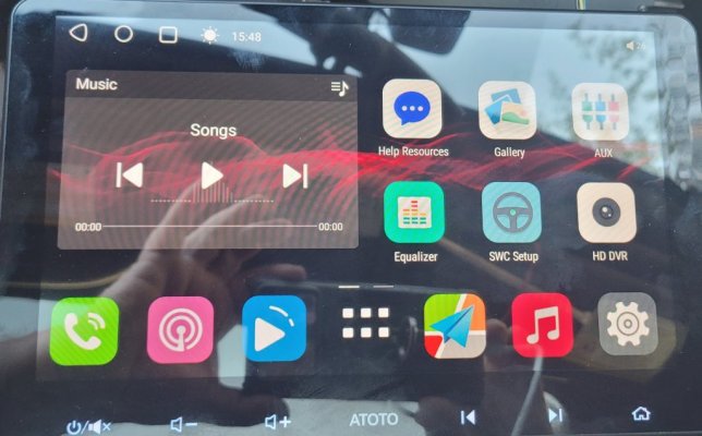

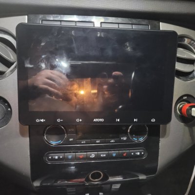

Sure. Mine doesn't have a CD player, but I believe they make them with CD Players. I had at first installed a basic Boss head unit with CD player. It had no customization and was very glitchy, so within a few weeks I switched to the Atoto. I don't really miss the CD player, I'm usually using the radio but if I want my playlist I stream Bluetooth from my phone.
ATOTO S8 Standard 7 inch Double-DIN Car Stereo Android in-Dash Navigation, Wireless CarPlay & Android Auto, USB Tethering, 2 Bluetooth, HD Rearview with LRV, IPS Display, SCVC, 3G+32G, S8G2A74SD
Seemed to have good recommendations and enough processor and ram which is key. I've been pleased with it, but again being an Android it took a while to get things configured. For example I didn't like the built in radio app so I bought one on the Play Store for a couple of bucks. Took quite a while to setup but it displays station logos, has a Ford background and digital GPS. And of course being Android I have Forscan to monitor my engine and can watch YouTube or stream TV if I'm stuck waiting for someone in my Expy.. which happens too often.

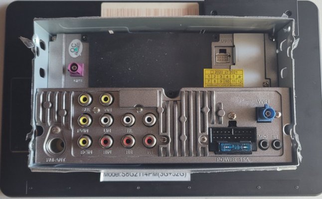

The install was pretty straight forward. The wiring harness went color for color except there is no switched 12 volt so I had to find a switched 12 volt under the dash. The factory head unit uses CANBUS to turn on. I believe Metra makes a more expensive adapter that integrates with CANBUS but with my plain Jane XLT I wouldn't have really gained anything.
