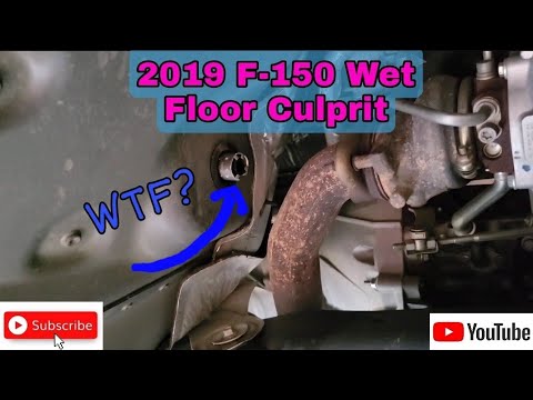

Hey all, I have a 2019 Expedition Limited and I have had some issues with the HVAC smelling musty right after when the truck had AC on. I've tried the disinfectant method on to the HVAC intake through the cowl but it comes back eventually.
Upon further review, it looks like F-150s and super duties also have the same issue to due to poor design on the AC Drain through the firewall. The fix is a rubber elbow (looks like a PCV valve elbow) as seen in this video
I have ordered the "Ford part" as noted through Amazon for $18 and I am currently waiting for it to try out if this is the right fix. I am just curious if others out there in the Expy/Navigator world have had the same issues.

Thanks. It is definitely mildew due to the water sitting in the system and not draining. The issues doesnt really present itself until late spring/summer time when AC is most in use. I have a steep driveway of 12-13% decline when going into the garage and I have been letting it sit for 2-3 minutes right after getting home on the steepest part of the driveway. In doing so, it eliminates the inherent water tension that causes the problem.
Once I have the elbow part, I'll also replace the cabin air filter and try to wipe most of the HVAC ducting with disinfectant

Just checked my carpet on passenger side: it's wet (not soaked, but wet). No smell, however, but can imagine that it will mildew after a while. Ordered an elbow to do the above fix.

I checked my 2019 XLT to see if mine was missing the 90° nipple coming off the the drain for the A/C against the firewall. Mine was not installed during the build date of 11/19. Surely creating in my opinion that condensating water in being forced not to drain properly and settling in the plenum creating 2 issues. Water being drained into the RS of vehicle and also creating a foul smell when the A/C is used. It seems to me that the drain without that directional 90° the hot air from the engine is being forced back into that small opening affecting the water into the cab along with the water not draining properly creating that foul smell when first the air is used. I have inquired about the TSB through my ford dealership to see if they would cover this part. I have 40k on mine and this fix would fall under the TSB Guide for repair procedure. I have the smell when I turn on the air but fortunately haven't had any water leaking into the cabin and wetting under the carpet. I will have this done either by ford buying it or paying for it on my own. Just my take on this matter.
