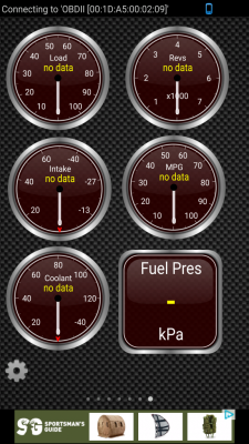

Wouldnt an android headunit with bluetooth OBD software be a better & cheaper solution??

Yep, Torque for Android can have a custom screen with gauges for any reading that the OBD can scan
You have to customize it a bit to add one for tranny temps, though, at least the free Torque Lite version... but it does have the option afaik

I have a cheap tablet that I run in the SUV now for the temps that I want to monitor.. I was just more curious if anyone had done this and what it would take...
