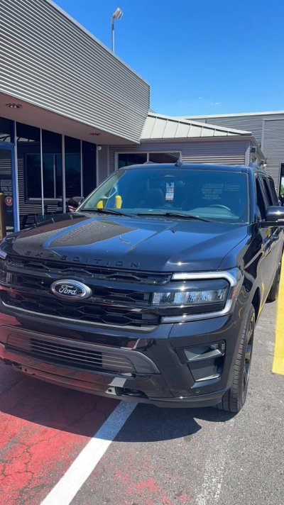

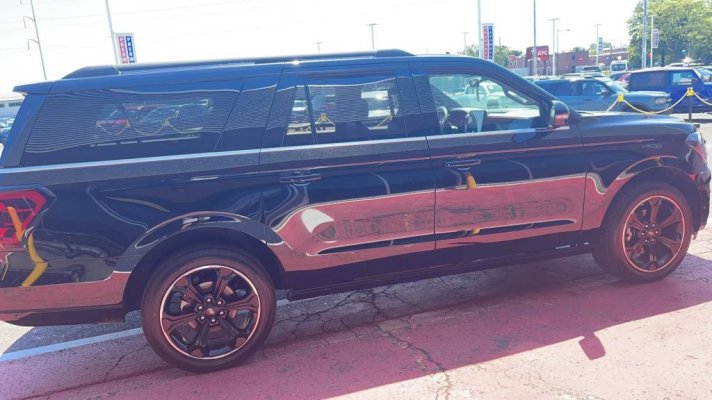

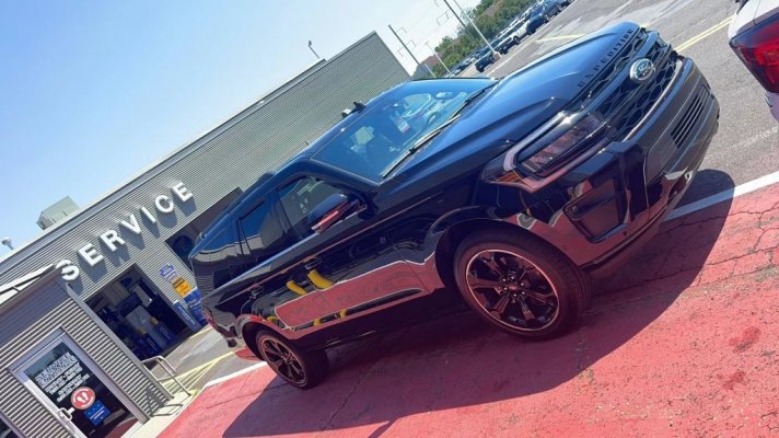

I would like to share my factory order timeline and the problem after I got it.
ordered on 1/13/2022 limited Max with stealth package(blacked out one)
producotion date 4/29/2022
delivered 6/2/2022
Problems
Pick my truck up from PA, and all the way to home on freeway, steering wheel is shaking when I go high speed, I thought that was the road condition, but it seems not, When i arrived NY on the express way with 45 mph, it seems fine, but if goes to 70 above, it shakes, i never seem this before. also stealth package comes with 22 inches wheels, went to local dealership today haven't got anything from them yet, and told me $150 would be charged for inspection, i was thinking if I don't get results from them, I would get my car back and going to body shop do the balancing.
anyone anyideas?
