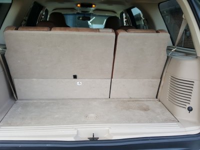

Hi, thank you for your prompt reply. You may be right about someone re-badged it to look like KR because the second row seats are now captain seats. The door panels have some stapler in them to keep the leather trim in place and visible. The exterior has KR emblems. The truck should have heated seats too, but there are no control buttons either.

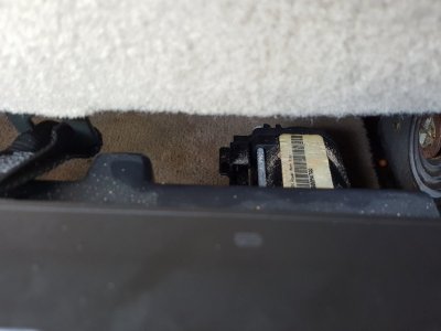

I did check everywhere in the front driver side and under the lift gate, I did not see anything. I attach some pictures for you to see the motors are not hooked up.

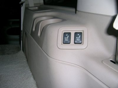

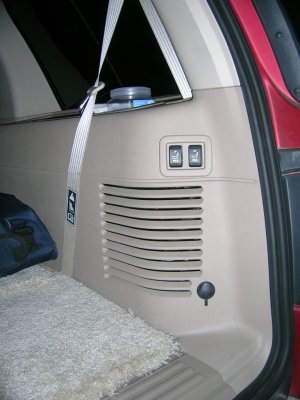

On my 2003 EB 4x4 there are TWO sets of buttons for the rear seats.
One set is the very rear passenger side corner above the power outlet.
The other one is on the driver's side on the wall just behind the 2nd row seat.

Wow! you have for switches and mine has none. I think Ford made a mistake on assembling the trucks.

I called Ford support and they checked he VIN number, they said that it was built with the buttons. But I could not find the buttons anywhere. I'm wondering if I can get the connectors, switches and panel to put in myself?

Carfax looked clean when I bought it. Even if repair, the connectors and the panel should still be there. Only the two motors under the seats are there.
