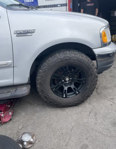

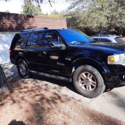

Hi,
I have a 1999 5.4 EB 2WD (rear air bags) with the factory 16" x 7" rims. The truck is not lifted or modified in any way. I would like to switch out the current tires (255/70-16) with a tire that, isn't necessarily wider but, has a larger diameter still using the factory rims that would fill out the wheel wells a few inches but won't cause rubbing issues. Any suggestions?
I went to Discount Tire and also asked at Costco and both places told me they would not be able to install larger tires, other than the standard factory size, on the rims due to safety liability. What do you do in this situation?? Take the rims off the vehicle and take just the rims to the installer?
The vehicle is used for around town and freeway driving, no off roading.
Any help/suggestions/photos would be greatly appreciated!

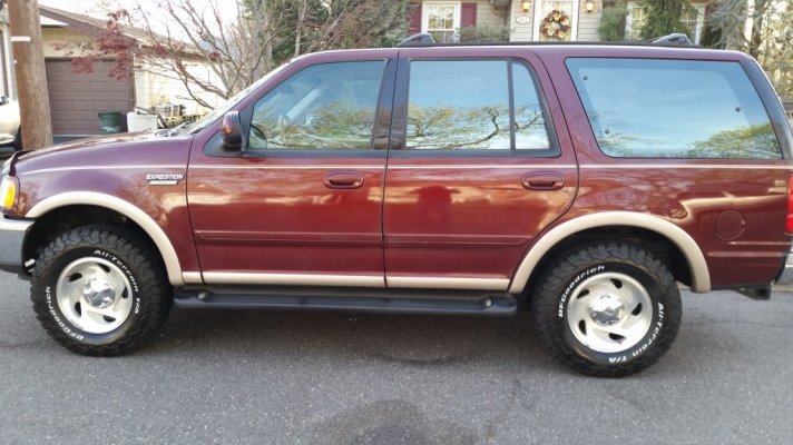

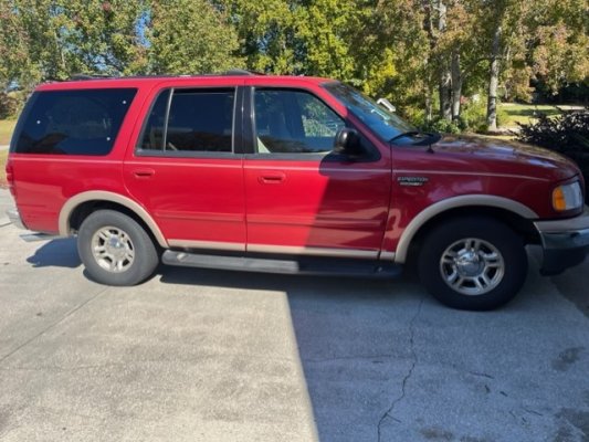

You can install larger tires on stock rims. I don't know the largest you can go without rubbing, but whatever size it is you'll be perfectly fine installing them on there.

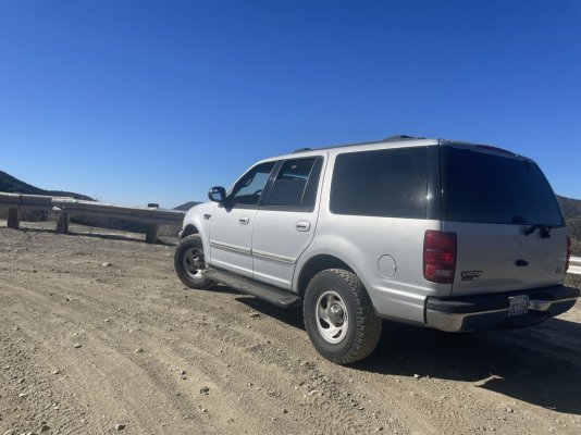

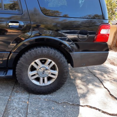

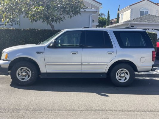

racing roman
Oct 30, 2022
Torrance, CA
I have a 02 4.6 2WD, completely stock and just put 265 75 16s with zero issues full turn to full turn.
Slowly updating it. It was my fathers and now he’s too old to drive so he gave me his truck.

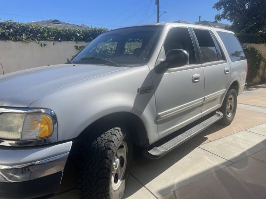

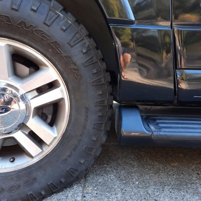

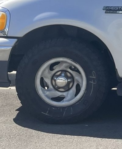

Capn Don
Nov 5, 2013
Arizona
Can't positively speak about 2WD, but we've run 275/75 16 tires on my wife's 98 4X4 without any rubbing issues for over 2 decades.
We got the same line of bull from Discount tire also about the rims. The odd thing is we already had the 275's on the truck and were looking to replace them. Sounds to me like a convenient way for Discount to sell a set of wider rims along with tires. As previously mentioned, check out other tire dealers in your area.
For rim fitment information check out the tire manufacturer web site or look at tire rack.com. They have info on approved rim sizes from the tire manufacturers.
Capn Don
Nov 5, 2013
Arizona
OOPS, I mistakenly wrote the wrong size in my post above. My wife's 98 XLT 4X4 has 285/75-16 tires on original rims. They are BFG All terrains. I've attached a pic of the truck as outfitted.
