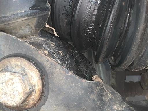

10' with 3/2 spacer lift and while replacing front CV axles noticed the driver side outer CV boot has been, and still is, rubbing the lower control arm. The new axle boot has already busted.
Anyone else run into this, or have similar issue?

Can you post a photo of the issue? Something about that seems not right and it may be indicative of a bigger problem.

Is the car currently jacked off the ground? When I put my truck on my lift my front upper control arms are resting on the coils, but it's fine when the weight of the car is on the suspension.
