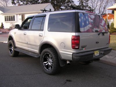

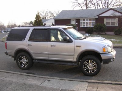

Lifted Expedition
Here's another one! :D :p

Most of the suspension lift companies say that awd trucks aren't compatible with their products. A body lift and perhaps some spacers will get you enough lift to clear 35s.
