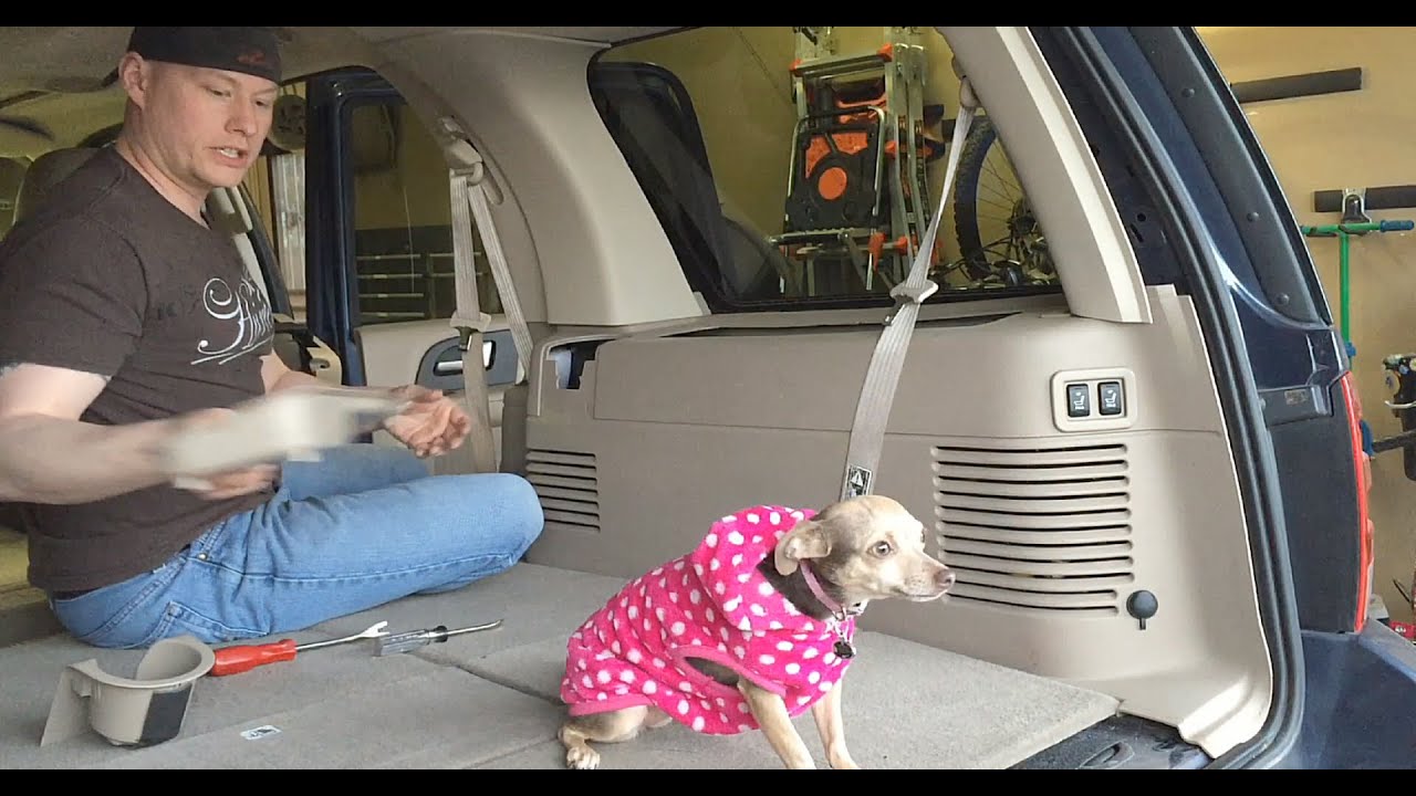

I’m the one who started this thread a few days ago. I followed the link(s) Bloodhound provided above. It turns out my problem was the rear blend door actuator #4 (the one that mounts on the side behind the panel). You have to loosen up the c and d pillars, and then pull away the panel to give yourself some room to work. I followed this video which is better for showing how to do actuator #4 in the write-up Bloodhound linked.
It was a bit of a PITA but I was able to finish it in about an hour. I was also able to remove and replace all four 8mm screws. Just took extra time.
I found the part on Amazon for $56 but didn’t want to wait 2days, so I went to my local dealer and got it for $68 which was worth it so I could just be done with it.
I’m sure my local dealer would have charged a significant amount of labor to remove all the pillars, panels, seatbelts, etc. I’m guessing $500-1000 for the complete repair.
I tested everything afterwards. No more clunking sound and heat/cold adjust with the thermostat. All is good.
