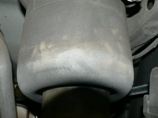

I'll share one thing with you that might be worth looking at. I had to replace the two air bags on the rear of my Expy about 2 years back as it was leaking down somewhat similar to what you have described. The bags, as they flex up and down during driving AND with age deterioration, will develop VERY SMALL hairline cracks near the base. Some days the rear end on my Expy would leak down and other days everything seemed normal. Yes, it could be something else in the system, but if the bags look similar to the photo I've posted, they definitely need changing.
ok good to know... I think that I will just go a head and replace the bags and valves just just to get the eventual job out of the way... I'm new to the 3rd gen world and can you send me a link to the replacement procedure? On my 1st gen it was easy just jack it up pull a clip on top and pop the air/electric connection and done but the 3rd gen's look more involved... I don't mind doing the work but I want to be prepared as possible so any videos would be great too as well as any tips! also what bags do you recommend for a the replacements? is the strut/bag one unit? I looked on online and I'm finding some are just the bag or am I looking up the wrong thing?? Thanks!!!!
