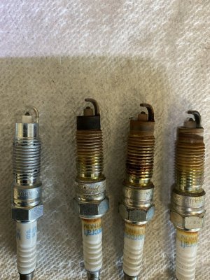

Purchased a new to me 2011 Expo King Ranch with 130k mi. When I test drove it, I could feel the rough idle and at wide open throttle it hesitated and the check engine light flashed momentarily. Code scanner didn't display any permanent codes, only a pending misfire on cylinder 6. I knew from experience, as this is my third 3rd gen Expedition, that in all probability the previous owner didn't change the plugs. When I pulled the old plugs, they were definitely worn and the gap was nearly twice the .041 spec of the new plug on the left. The engine purrs like a lion at idle and screams like a tiger at WOT with no hesitation.

I'd be surprised if there was on an '11. That problem was overcame after around '08 MY trucks...head redesign and a move to one piece plugs. ;)
If you've seen a few, you can tell at a glance that those he took out are the later design. Hope this helps :)
