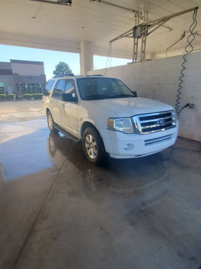

Been on the forum for bout a month. Growing up, we had a 2002 Navigator and this thing is nostalgic. Named her Blancha. 2010 5.4 v8 with 133k fron autonation in Scottsdale, AZ. Here's some pics. Question.... when should I change the oil on this used suv ? The distick shows solid ad of now. I'm thinking change it on general purpose. Also, what other basic services should I perform since I just got her? The list of maintenance performed was alright and the used car inspection from a local dealership showed all good. Def don't wanna overkill. Talk to me forum
