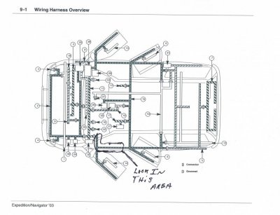

The Ford manual doesn't go into electronic detail, so the answer is "could be". The cluster uses two grounds, one in each connector. The wire in C220a is black while the wire in C220b is Pink/Orange. You may want to reflow the solder on those pins.
Both wires also show a splice before they go to their individual grounds so that may also be the cause of the problem.
I don't remember how many of the trim pieces need to be removed to get the cluster out, but it isn't bad. Just don't pull the entire dash.
