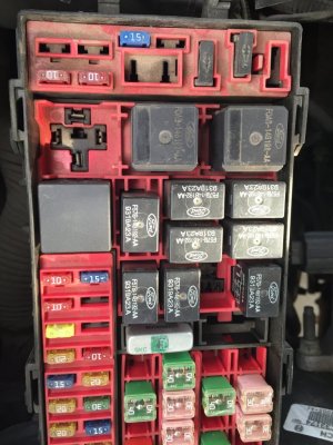

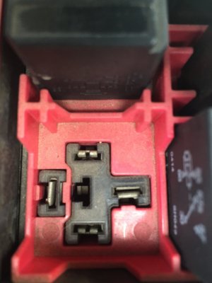

So I am ramping up for my electric fan install and have question about hooking into "12V ignition ". The picture below shows where relay 302 resides in the fuse block. Per owners Guide, this relay controls " Trailer Tow Battery Charge Relay ". I am not using this function and there was no relay there to begin with. I would like to use the one terminal on that relay socket for " 12V Ignition " source for my fan controller. I have verified ( looking at the picture ) that the top terminal is an " ignition source ". I do not want to have to rip into my dash and splice wires to accomplish this. Does any one see an issue with me using this terminal for ignition source? Thanks

So what do you think about me using the terminal on that solenoid receptacle for " ignition sourced " 12V? In the first pic, it's the one at the top ( 12:00 ), in place where the Trailer Tow Battery Charge Relay is supposed to reside

Could you tap a branch circuit there - yes. But that isn't the best way to do it. If the battery junction box has a positive lug on one end you could tie the circuit in there and run the wire with the existing harness, just zip tie it in place.
