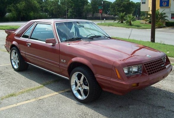

And Ford has a paint code for 5W which is a color from 79' like the pick of the fox.

Thanks!
How would I have known it was G3?
I looked up the various paint codes for 2008MY Expeditions and cross checked the sales brochue which touts the King Ranch features "Pueblo Gold Accents".
Ford changes the exterior and interior paint codes every so often so it's important to make sure you use the code for that model year and vehicle.
According to the Ford Paint Code Chart:
"W" for a 2008 Expedition is "Charcoal Black" but on an F150 of the same year its "Tan Light Parchment".
The "Arizona Beige" on the F150 ended in 2006 then it went to "Vintage Copper". Only the Super Duy still used Arizona Beige in 2007.
