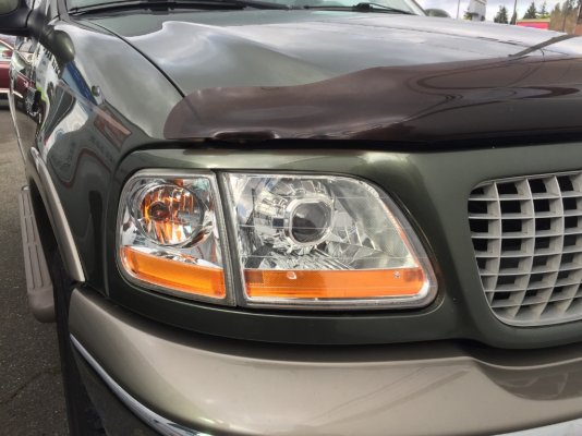

I had aftermarket clear headlights to begin with but they fit wonderfully, and look pretty good compared to the shape of the headlight itself, oblong versus round. The shrouds had to be shaved on top and on bottom due to them being too large but I think they wound up fitting quite nicely. Just be ABSOLUTELY positive of rotation before securing completely because my drivers light is a bit askew, and with such a sharp cutoff it looks a little funny compared to the passenger side. But take a look!
