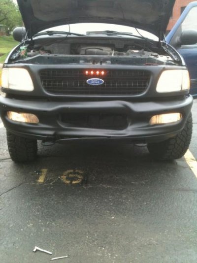

So far I have 3 of the 4 mounted. Thunderstorm rolled in so I am waiting to put in the 4th. Basically they are amber 10mm LED bolts from superbrightleds.com. I used 1-1/2 in corner brackets just cause that is what Walmart had when I was there late last night. 1in corner brackets would work too. Then I just got an epoxy from O'Reilly and started glueing them on. I will post a pic of two of them on so far in a little bit. If you want to know what the finished product looks like, the pictures on the first page of that link I posted has just that.
As for wiring, my plan is to run the positives from each light into one main positive wire, which will then run over to the minor positive wire on one of the turn signals. Ground will then just go to the frame. From what I can understand, this should work, but let me know if you think it will not.
I will post more pictures once the rain lets up including what they look like mounted to the brackets.
EDIT: Here is the pic of the two in so far, the wires will eventually be tucked away up above and I will paint the brackets with plasti-dip as soon as everything is in.

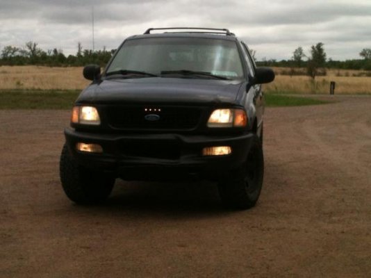

I had seen a couple guys that had put some space between theirs and it did not look as good to me. If you look through that F-150 thread in my first post (there is a bunch of pages, but there are a lot of interesting pics) you can see what I am talking about. This was the way that seemed to look best.
Camera kind of let me down on this one...
