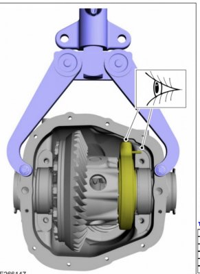

had my back end start chattering when backing up out of my driveway a few months ago sporadically while turning to exit my culdesac. was driving home and felt it while taking some winding roads on the way home 2 weeks ago. Brought in for evaluation.
I bought this vehicle new. Meticulous maintenance and don’t drive it much now and drive my hybrid back and forth to work (120 mi round trip). Dealer was in TN and I’m in GA. My preferred dealer couldn’t get me the vehicle I wanted so had to go out on my own. It had a third party “lifetime power train warranty” from the dealer. Usually you can use the warranty contract, at best, for butt wipe.
Just got word from my dealer the locking diff actuator failed and was partially engaged and grenaded the rear end.
No I don’t accidentally engage it. Yes I placed it in and out of lock to see if it changed the chattering. With it on, it would fully lock but with it off, the pin wasn’t retracting all the way according to my service writer. Sometimes going in lock and out of lock would eliminate the chatter.
I placed in AWD and 2WD and 4Lo as well to see if that would change it previously and it wouldn’t.
All in all roughly $2100 repair estimate right now. Hope the third party “lifetime warranty” I received when I bought it from a dealer several hours away holds up. If not, it’s still getting fixed.

Mine just failed at 25,000 miles. They took it on last Thursday and it got finished today. I didn't pick it up yet, but its supposed to be ready for me tomorrow as they had to bolt the rear suspension back in it.

Same deal the pin not retracting and rattling?

Deadman,
did they say what the fault was?
Same type of thing. The hydraulic actuator wasn't releasing so the posi was going in and out. They replaced ALL the internals in the rear end housing. The housing was re-used, but the guts were all swapped and also the hydraulic actuator of course. The service guys didn't have a lot of detail for me, but I'm just glad its done. They're delivering it to me tonight, so I'll know more after I get some miles on it.
I'm sure these won't be common failures for a while, because MOST of the 2018's did NOT have the tow pack and electronic locker, so they won't have the faulty parts. 19's had more tow packs, so the number of failures will increase as those get more miles on them.....
