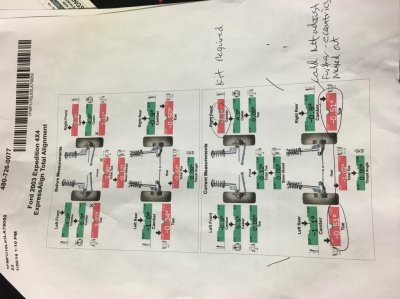

Just installed the 3/2 leveling kit with some 295/70/18 Cooper Discoverer ST Maxx tires. The tire shop said they could not align the rear due to the eccentrics being maxed out. They could not correct the rear toe and it currently sits like \ _ / in the rear due to everything being maxed out. They suggested I get a toe adjustment kit. Anyone had to purchase one of these?
Also, has anyone had issues like this after installing a 3/2 spacer lift leveling kit?
I'll try to upload some pics of the truck and the alignment assessment.

2004XLT,
That's what I was thinking. The toe adjustment kits don't look much different than stock. I'm thinking those are more replacement kits in the event the stock one breaks.
According to the guy that was performing the alignment, he stated he would adjust the rear toe but could not achieve any better than -0.51 degrees.

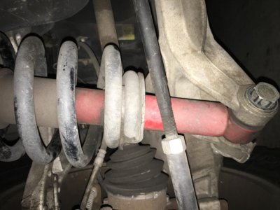

Here's a pic of the tie rod, both sides are about the same. How does that compare to yours 2004XLT?

2004XLT
Sep 26, 2014
324
19
CT
Looks same as mine, I doubt you need to buy anything to get it aligned. If you have the tools I would get that tie rod end unscrewed a few threads, see for yourself that it's not too short and running out of alignment. I would adjust it so your toe is too far out, then if the tech says you don't have enough room to get it straight you can call bs.
I got an alignment a few days ago and the tech said he got everything in spec except he couldn't fix my negative camber on one of the rear wheels. Last alignment it was on the money and I know nothing is loose or worn, so there is no way it could have run out of alignment. I think it's because really no other half ton truck has independent rear end like the exp, the technicians treat it like its a tahoe with solid rear axle.
