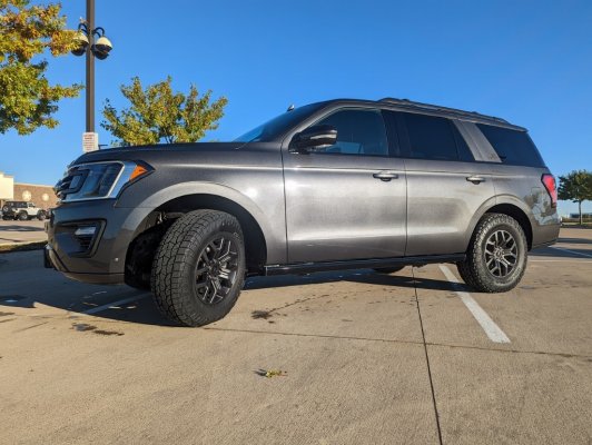

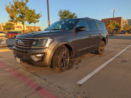

Get normal size wheels with tires with some side walls.
Wonder why they do this stupid crap..
No sidewalls
I really don't see the point of wheels that are greater than 20" in diameter. I think 18" and 20" are the sweet spots.
