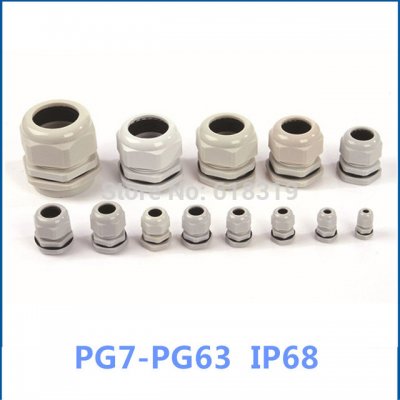

Cable glands work very well for sealing up to the roof and around the wire. You would just need to figure out the correct size based on what your running
