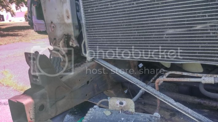

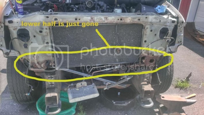

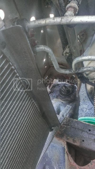

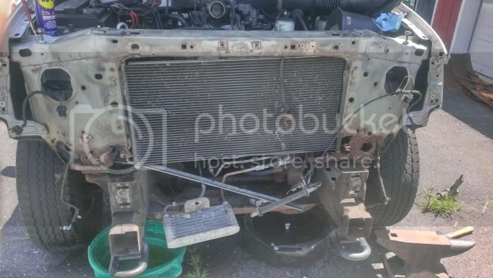

Bought a 2000 expedition Xlt 4.6 for 3 grand and went to do a oil change that same day
And saw the radiator and ac condenser just laying on the frame.
The bottom of the radiator support is gone lol.
So looks like cutting out the old one and welding in a new radiator support is the way to go
I'll post a pic when I get to my desktop

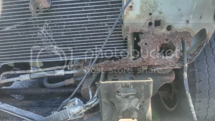

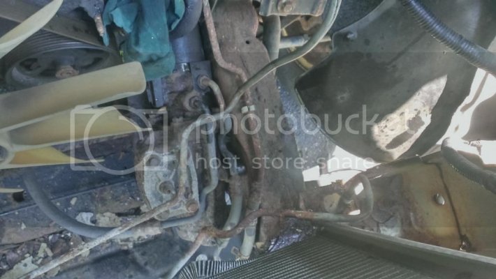

yeah.. mines pretty bad.. i bought it for 3 grand. took it home. on the same day i got under to change the oil and just looked up and saw the radiator and ac condenser just dented and laying on the frame.. took the front bumper off and then shit myself. the only rust that i found thats bad is the radiator support, brake lines, trans lines, power steering lines. and the shock absorbers are rusted pretty bad. but i bought all that stuff to be replaced. should be all coming within the next week or 2.
