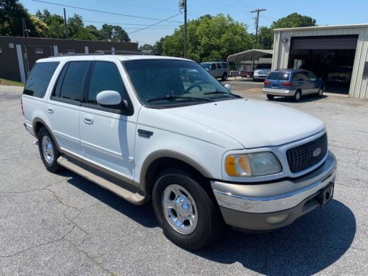

Recently picked up this 02 EB Expy with 137k. Its in really nice condition but the bulb in the side view mirror turn signal is out. So whats the trick to replace it.
