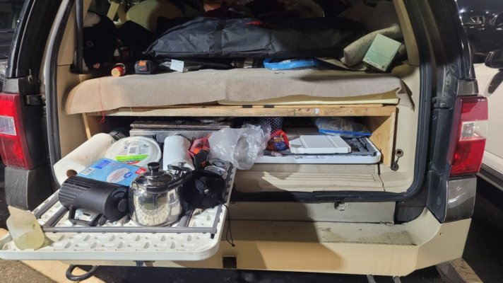

Yeah you inspired me to get mine done. 4' banquet tables from menards make excellent slide trays and you have a table also.
