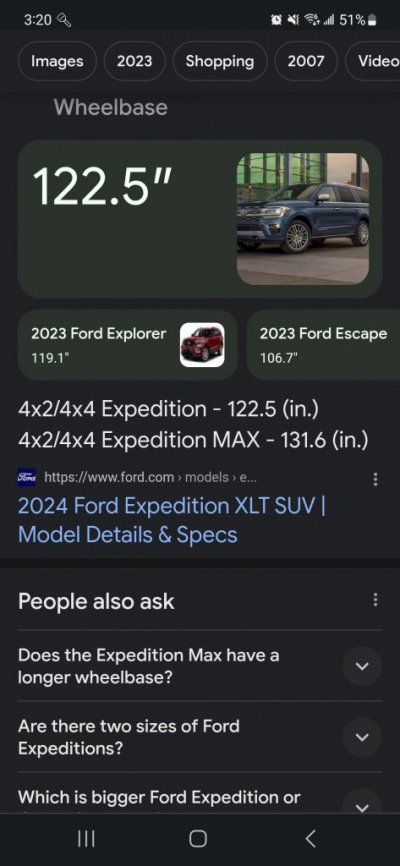

The Max is the superior option for towing. The longer wheelbase is better for stability, and you'll appreciate having a larger fuel tank.
The Max has the same wheelbase, it just has a longer body, about 9" longer entirely in the back.. <= WRONG, I misremembered what I'd read a few weeks earlier
