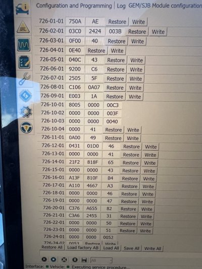

is it possible from ForScan to disable the turn signal in tails lamps? (both sides only tails lamps)
If yes then in which modul i should change it??

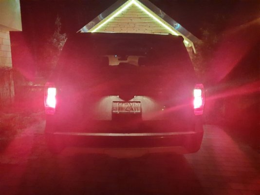

Currently i got to the point that in one assamble i putted a led light (white + amber) a took signal from mirror - i have revers and turns signal
in 2 assemeble i cutted the wire which was responsible for stop + turn - so i have red light
From 3 brake stop light i get wire and putted to red assemble - effect - on one side i got brake light on second no
and i do not know why

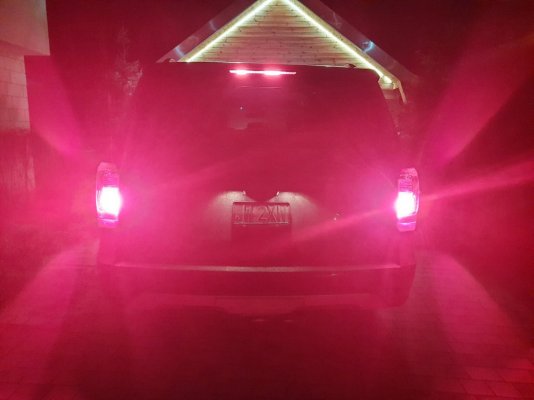

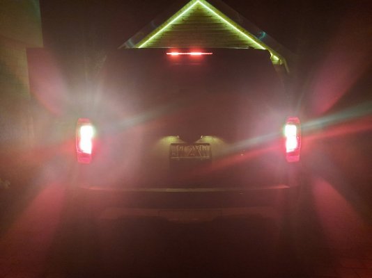

Dear all finally finish the topic
So for the future
I got lights according to EU law
So normal light red
Stop light red
Turn light amber
Revers light white
Fog ligh red
In the orginal assenbly
in upper socket i got revers + turn
in lower assembly i got drive and stop light
FOG rear light is seperate lamp under the bumper
How to do it
upper socket
Revers stays as it was

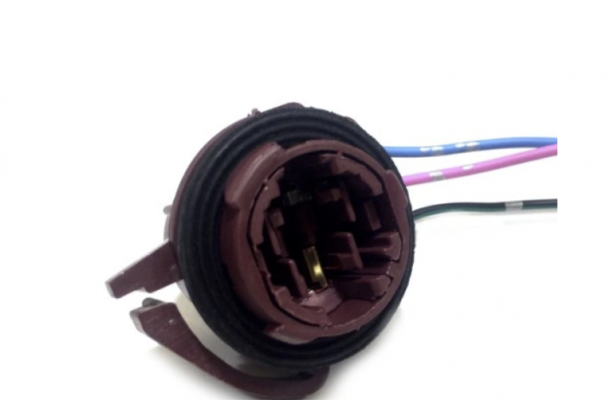

I bought a bulb socket with 3 wires
From mirrors i took signal for turns
Lower socket
Driver sign stayes as it was
I cut of the turn cable
From 3 stop light from the hood i took the stop light
But i needed to change bulbs to led bulb due to lower Amper voltage (otherwise it was not able to work)
