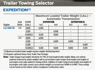

I’ve decided I’m going to spend a bit more and try to find a nice 2013 or 2014 Expedition Limited or King Ranch. I want to be able to tow a travel trailer, but don’t yet own a trailer either, so I want to make sure I get the most towing capacity so that I am not too limited when picking the trailer.
If I’m not mistaken, all 13 & 14 Limited & King Ranch come equipped with the heavy duty tow package as standard equipment. Yet I can’t seem to easily determine the max towing capacity. I’m using a VIN decoder from here to look at options:

Do these seem accurate? Is the King Ranch capable of 9,000lbs and 900 tongue while the Limited is “limited” to 6,000 and 600? Or will I find some Limiteds capable of higher weights as well?

I thought the difference was between the short wheel base and long wheel base Expeditions.
Longer models weigh more to start with and the tow capacity (as in my owner's manual) is less for it than for the shorter model.

I don't know if all limited trims have the tow package. Mine does, and the easiest way to tell is is the trailer break controller buttons in the console, and the 7 pin wiring harness. It also states in the manual that it includes the aux. trans cooler and radiator upgrade.

Im hoping there is an easy way to identify this while browsing online. If trailer break controls means HD towing, that would be perfect.
Even with HD towing, are their other options which are required to pull the fully allowable trailer weight? I assume a weight distributing hitch would also be required (and needs to be added unless the previous owner already added it)... but other than a new hitch, would all other gear be included (transmission cooler, etc)?

All you need is HD tow. They all have the dash mounted trailer controller. Watch out for aftermarket installations. To hit the 9k limit, use of a WDH is required. It will not come as part of the truck. It just plugs into the normal receiver.
