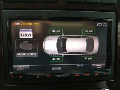

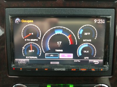

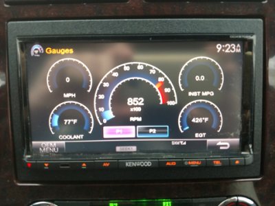

The information is there, but Ford apparently doesn't think it should be shared openly with the end user. I replaced my Sync radio with a Kenwood head unit and an iDatalink Maestro so that I could keep my steering wheel controls and boom, all info is available via the Kenwood. Independent tire display comes up automatically after boot, before it switches to the radio display. It is available at any time via Kenwood menu options. I can also monitor most engine sensors and see engine codes. I can see ignition timing, fuel to air ratio, exhaust temp, instant mpg. It can even display g-forces during acceleration and braking, as well as 0-60 acceleration time. It ties in with the sync computer and also to the ECM.
View attachment 22921 View attachment 22922 View attachment 22923
purevw, how much did that cost. What year Expedition do you have and was it hard to install?

lurking around, but just bought a 17 EL Limited. Was quite disappointed to find that it won't display the tire pressure. This will be used for towing and hauling for dive gear so even if it will just give me a list of the 5, I'll be happy. My buddies 16 F-150 will display it and I get that we may not have the hardware, but here's to hoping someone finds the code change to spit it out. If Kenwood can do it, hopefully we can find it
