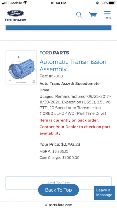

With that much mileage, best bet would be to buy a whole unit from Ford and it would then get all the updates like the valve body and torque converter. See below at the Ford.Parts website. Complete transmission with a warranty and all updated parts is usually cheaper than getting one rebuilt and just trade in the old one as a core.

I would still check with Jasper. Not sure if their warranty is for this particular Trans unit although if it is they offer a 3 year warranty or 100k. Would seem to be a more plausible alternative if this would be the case. Being the case, waiting for a Ford Trans would seem pointless seeing all are going into the production line models.

First, stay away from Jasper.
Either buy a dealer unit, 3 year/100 or unlimited miles, I forget right now. Have the dealer or reputable transmission shop perform the install. Shops that don't R&R these regularly should not be used.
Or, find someone who has a reputable builder, I have one in my shop, but it's 3,000 miles away.
These can be rebuilt, plenty of reputable aftermarket parts available from Transtar, Precision, or others. Also, there is no such thing as a partial rebuild. You don't spend all of that time removing it, taking it apart, and only change a few parts, you change every soft part and any hard parts that show damage.
And, stay away from torque converters from TC Converters, at least for now. They seem to be having some issues with their clutch supplier.
Make sure they replace the valve body as well. Replacing the valve body or buying a dealer unit will both require reprogramming.
I hope this helps.
