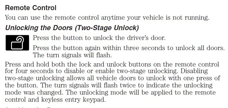

I recently got an 07 EL and want the remote to unlock all of the doors with just one push of the button. Is the truck capable of being programmed to do this? Will the FORScan do it, or is there a different way?

My 2004 requires 2 pushes on the FOB to unlock all doors. The first push unlocks the driver's door, the second push unlocks the rest of the doors.
Don't know if that sequence can be changed.

Right, that is mine as well, but I am hoping I can change this behavior like you can in most other vehicles.

From the online manual -
Unlocking and locking the doors and liftgate using keyless entry To unlock the driver’s door, enter the factory set 5-digit code or your personal code. Each number must be pressed within five seconds of each other. The interior lamps will illuminate. To unlock all doors and liftgate, press the 3 • 4 control within five seconds. To lock all doors and liftgate, press the 7 • 8 and the 9 • 0 at the same time. Note: The driver’s door must be closed. You do not need to enter the keypad code first. To open the liftglass, press the 5 • 6
