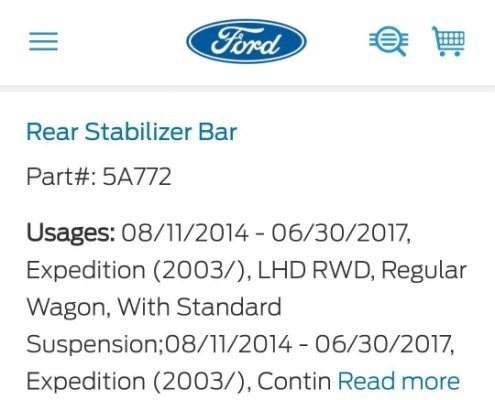

I have the HD tow package and my sway bar is the same part number as the same year vehicle without the HD package. I couldn't find a separate part on the Ford site to indicate there was an alternative.
