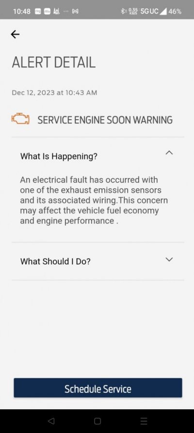

On another note, I appears these messages in the ford app are indeed specific based on this thread I found.
