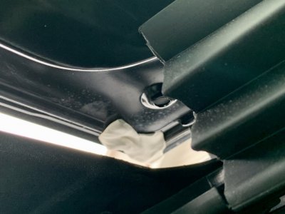

RDDriver
Dec 10, 2019
Chapel Hill, NC
I’ve had this issue on my ‘18 Expedition vista. Loved with it for a while then the roof got stuck and broke the opening mechanism. Had dealer replace with what they said was a retrofit kit (bad original design?).
Creaking when closed started again a few weeks later.
Took back and reproduced with aggressive turning. Tech added lubricant (Krytox) and creaking stopped for a few days. bought my own Krytox (not cheap) and applied but result was only slightly better.
Trying the felt tape approach not but not sure exactly where to position. Pics would probably help at least in my case.
I used electrical tape as I couldn’t find any felt tape. I put the tape on the top end of the outer metal piece as the OP suggested to be a buffer between the two metal pieces connected by the Torx bolts. Happy with initial results and known where to focus attention if it starts making noise again.
