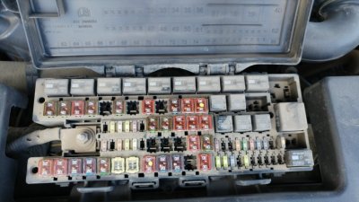

today tested the engine compartment fuse box, and after test all fuses I found 10 fuses not working they are as follows (according to the manual page 287):
*** UPDATE: I rechecked all engine compartment fuses with engine on and off and took some of them off , results is they are working fine
I didn't have check engine light !! , Any help is much appreciated.

I doubt you have blown fuses, looks more like a dust/sand issue with making good connections. A couple cans of contact cleaner sprayed into each set of terminals with the fuses or connectors removed would help. Remove one at a time and spray. You can't run the engine with the pcm fuses and coil fuses blown so how are you able to read the 13.8 voltage?

If you have 10 blown fuses then you have a short circuit somewhere.
I just rechecked all fuses in the engine compartment fuse box with engine on and off and took some of them off to check indivisually and they are all fine.

Thanks man, it is as you said I recheck all fuses and they are fine, as for the battery terminals I changed the battery the asked the seller to clean them for me but I didn't check after him I'll try cleaning them my self and get back with the result.

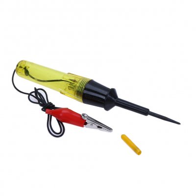

I checked in all cases engine off/on any doubts took the fuses off test continuity, but mostly with a simple fuse tester just like the attached image.
