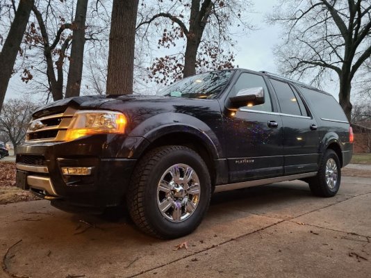

I got the DM-V2s installed on my truck today, keeping the 275 width.
The first shop wouldn't install them because of load rating. The placard load rating on my truck with OEM 20s is 113 so I thought I'd be fine with 114 tires, but apparently with 18s the OEM recommended load rating is 116. What is particularly confusing is it looks like up until 2014 114 was recommended for 18s. I'm not sure why starting with 2015 it would be higher and only for one tire size.
Rims are takeoffs from a 2012 F150. This style center cap fit over the axle shafts fine without modification
