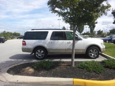

All installed, it looks good.
I got just over 2” lift rear and just over 3” for the front – all measured from center of the wheel to the arch, above it.
Once I finished the installation, it was 2.5”/3.5” but it was settled to about 2”/3” after driving the EXPY for a mile or two.

Maybe its just me but I think that the front is higher than it should be.
I didn’t understand why the rear only gets 2”, to begin with and I still don’t get it.
Although the lift performs is as promised (3” front and 2”rear), I think I’m missing an inch on the back.
I definitely should realign the headlamp.

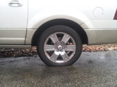

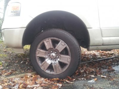

After installing the 3/2 lift/leveling kit, I went to get some measurements, to see how much rubber I can get under the EXPY.

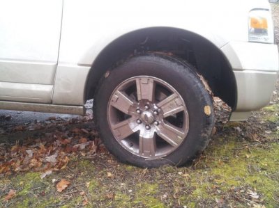

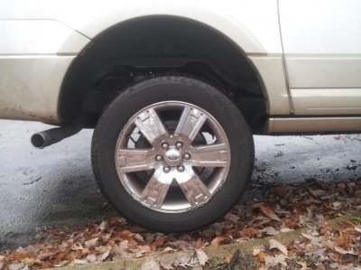

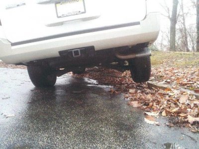

In order to do that, I got to “flex” the suspensions – to fully compress one side and get the minimum space between the tire and everything around it, in order to determent the largest tire size that will fit without rubbing/touching anything.
Well, first I learned that “flexing” is not a term that can described any action of the EXPY’s suspension – the truck articulates as an ironing board… at list as long as the sway bars are connected.
Ford Expedition EL in Full Articulation .. so-called.jpg Rear Wheel is off the ground.jpg Rear Wheel is off the ground #2.jpg

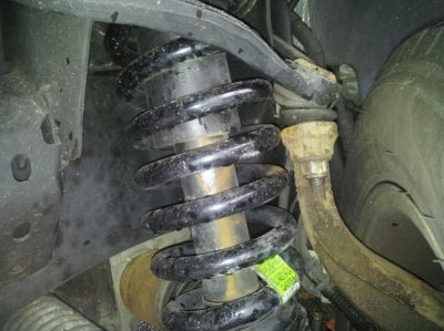

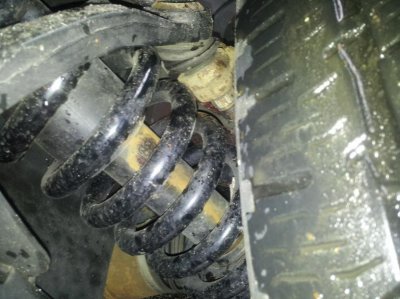

Second, as I suspected, at full compression the (front) upper “A” arm’s ball joints /knuckle come into contact with the spring – in both sides...

The upper “A” arm move down and get pushed hard to the spring. Although it is not much of concern if you don’t get off the pavement, it is definitely something to take under consideration if you do go/get into uneven terrene.
Front - Fully Dropped.jpg When fully dropped the Upper “A” Arm ….jpg and Bull Joint -Knuckle get pushed to the spring.jpg and some better look.jpg
I can see why some manufacturers have concerns with the angles and powers the ball joints have to deal with, with that kind of kit.
If you want to do this right, you have to consider modifying the front upper “A” arms and/or ball joints and/or knuckles...

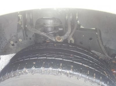

As for the tires, the closest parts to front tires remain pretty much the same, despite the 3” lift.
I have about 2” between the tire (OEM 275/55/20) and the power side steps and a little less than 1.5” from the tire to the upper bull joints/knuckle.
Front - Fully Compressed.jpg Front - Fully Dropped.jpg Rear - Fully Compressed.jpg Rear - Fully Dropped.jpg
Bottom line – apart of the EXPY is looking A LOT better and is better proportioned (especially with the soon to come larger tires), I don’t see significant improvement with the 3”/2” lift/leveling kit – at list for my purposes ..

That sucks about the contact....i wonder if there is a way to put in a stop to prevent contact
