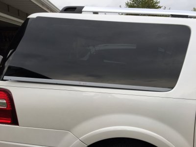

I wanted to add a little bling to my 17 Limited EL. I kind of liked the Platinum with the chrome strip on the rear side glass. I found these on eBay. They were very easy to install. It took about 30 minutes per side. I went slow and was careful.
Here comes my usual wall of pictures: :D
If you are interested, I bought them here:
http://www.ebay.com/itm/07-17-Ford-Expedition-EL-Rear-Cargo-Chrome-Window-Sill-Trim-Accent-Door-Accent-/302342431097?fits=Make:Ford|Model:Expedition&hash=item4665036179:g:840AAMXQWzNSdAak&vxp=mtr
The first thing I did was clean the glass then I used Denatured alcohol to get any wax or grease off the window and then I polished it with a dry towel.
I used some scotch tape to position the trim in the general area where I wanted them to be.
I then flipped them up and removed the 3M tape protector strips and carefully re-positioned them and adjusted the edges to fit where I wanted it to.
I burnished the strips down and then pulled off the protective coating and then did a lot more burnishing to insure a good bond with the class. I went over it at least8- to 10 times to make sure and burnished down all of the edges. I also had the windows open and squeezed the strip to the glass with my fingers as far as I could go toward the front.
Then I did the other side.
I think it turned out very very well and look very close to what the Platinum has on it's 3rd row windows.

JRC, it took about 30 minutes per side, but I was taking my time. I cleaned the glass then wiped it down with denatured alcohol and dried buffed it a little with clean cloth. Then I taped it to where I thought it should go and moved it around a little until I thought I had it perfect, then I flipped it up took off the backing on the tape and checked it to make sure that it was still where I wanted it then I stuck it to the glass. I Had the window open so I squeezed from both sides as far as I could get and rubbed the hell out of it to make sure it was making good contact. I don'w want them to come off in the automatic carwash. :) Today I gave them a nice coat of wax to keep the acid rain off of them. :D
