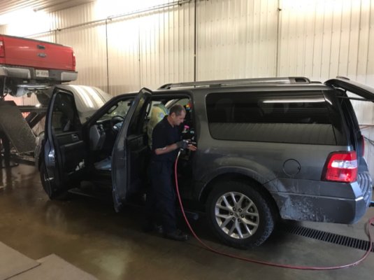

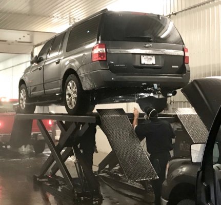

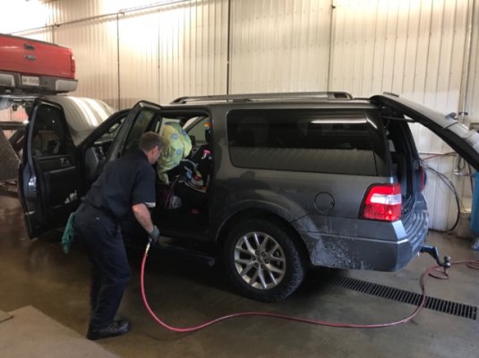

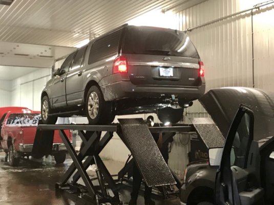

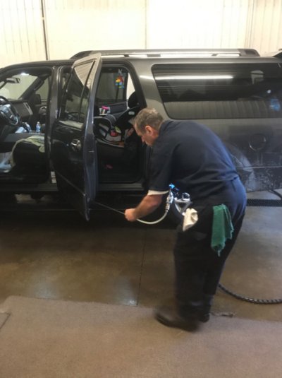

Took my truck across the border into Canada and had Krown treat it today. They drilled holes in all of the body panels and rocker panels. Pulled the tail light housings and sprayed their Krown oil into every hole and orifice. Then they lifted the truck and sprayed the entire undercarriage, wheel wells, everything. They sprayed the engine compartment door sills, liftgate sills. Very very thorough. I was impressed. Not my first Krown experience but the first time with the Expedition. I’ll have it treated again this coming summer and then just have it done yearly after that. 62f07877d6fadb91e6cc5222e0ba7b9e.jpgda9157e021868134cd149dff3107a26a.jpg080d6d3609223c4fdf26e29b6ccc62fe.jpgd5a147a9efe9b3501e73789bd3f68faf.jpg31eea086c1f06af16004967f18aa90d4.jpg17f16e9d0c5e04a524a56bf757e37f9f.jpg

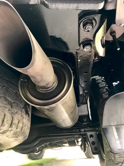

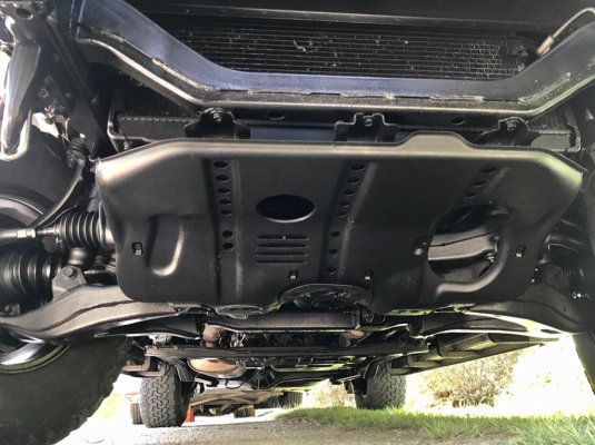

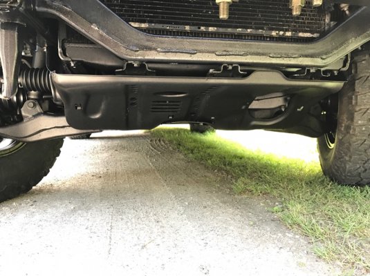

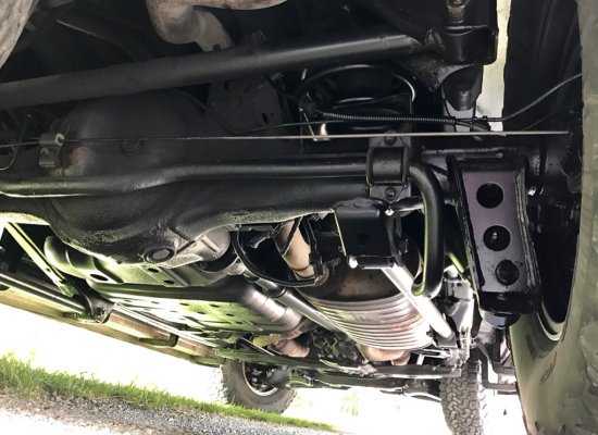

It sounds like you had a bad service Center. I’ve never heard of anything like this. My Land Cruiser had just under 300,000 miles on her was was 20 years old when I traded in for my EL. These are underbody shots a month before I traded it in...was Krowned every couple years: 90d3a90e908cb032e27e7be285be117a.jpgd063e8bad855acee2e5e7130d302f978.jpgae14d32e857d8d17976507b1e77867af.jpged96aa9d049353ec8a970d8c3be22ec6.jpg
