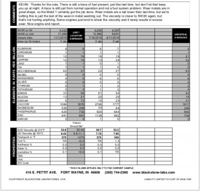

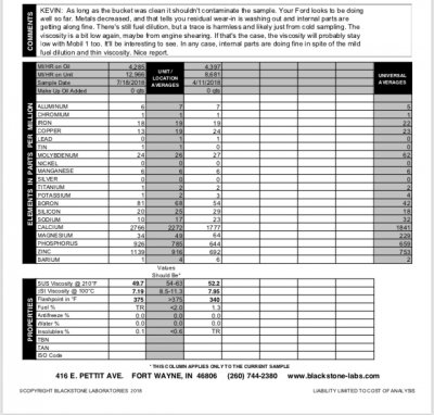

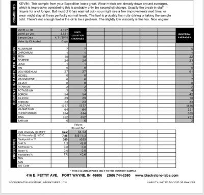

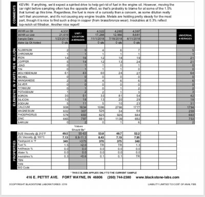

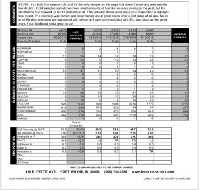

Chuck, I’ll dig around for my reports and try to get them up on here for all to see. Basically from what has turned up in the reports, nothing seems to be of concern. I just thought it was interesting how hard this engine is on oil. Then again I’ve never taken samples like this on any other car I’ve owned. I do run samples on my mustang but that’s the 5.0 V8. Different animal.

Kevin --
Thanks for sharing your oil reports. The narratives are the important section and there is nothing in them that's any concern. I won't have anything to compare them to for several months (my Honda samples don't count).
Blackstone Laboratories has a large data base on our engines. "Your EcoBoost looks great to us" is the bottom line.
