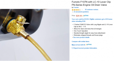

This but a different model that is adjustable and drains straight down.....I put one on after the first pain in the a@@ oil change. Drains the oil straight down instead of sideways - what was a Ford engineer thinking about that day?
I've never understood why any of the engineers put oil drains in the side of oil pans...
