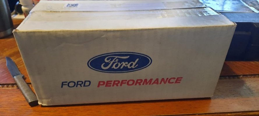

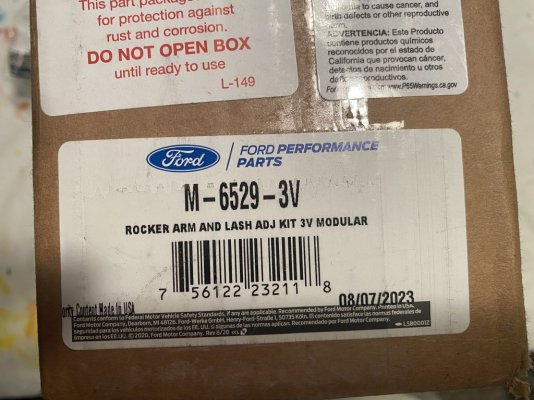

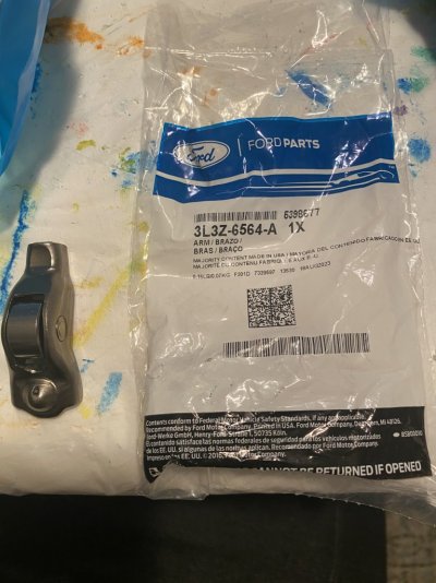

Hey Guys .. opened up the top end and ready to replace the timing gear .. have got genuine OEM kit and saw this link for the RF and Lash Adjusters ...
Comments seem to state these are OEM .. any thoughts??View attachment 78872
From Ford performance Web Site
  • Fits 4.6L 3V cylinder heads
  • Original production part as used on 2005-2010 Mustang GT
  • Sold in engine sets (24 rocker arms and 24 lash adjusters)

They are Genuine Ford. Alot of Ford Performance parts are just ordinary Ford production parts repackaged.
What I can’t tell you is if the 4.6 and 5.4 assemblies are the same, looks like they are but that will need to be confirmed.

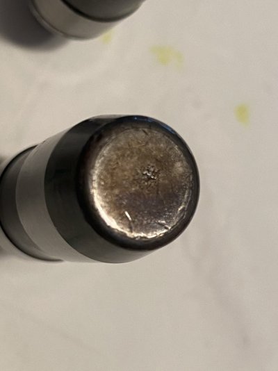

Giving this set a good look. Installing a timing set and high volume pump. Both tensioners had failed seals on them. 106k on truck. Rediculous. Anyhow, the passenger side followers had a noticeable amount of play in them, as compared to driver side. Little wear on cam bearing journals too.
