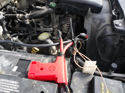

Great idea and I do believe the dealer replaced both battery cables, then 'built' the fusable link into it since they could not find a factory or aftermarket harness.
It's early here right now (dark out), but I'll take a picture later today. I asked the service adviser to point out their work. The work really looked top notch.

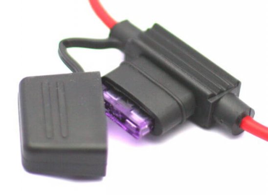

Not the best pic, but they did replace both negative and positive cables/terminals and rebuilt the fuse into the cable. It's actually a spade fuse which makes replacement a snap. I have a bag of fuses and relays after paying a shop to replace the passenger well fuse box, so I'm covered with backup. I also have spare headlight bulbs, turn signal bulbs in the glove box. Pretty sure I'm good to go now. Took it for an extended shakedown drive this morning before I hit the freeway later this week. I should probably figure out a way to cover/protect the fuse though... I'll make a small cover, or at least tape it over with electrical tape. I looked online there are inline spade fuses like these with a cover built into them. I wish they used one.

Cut a slot in the sides and it will protect the fuse. As seen still accessible. Pretty sure the polycarbonate PC plastic will hold up. Also added silicone to the slots I cut. Should be water/weather resistant. All the other fuses have covers, why shouldn't this one?
I might invest down the line in putting a proper in-line fuse with cover like shown above but this will work for now.
