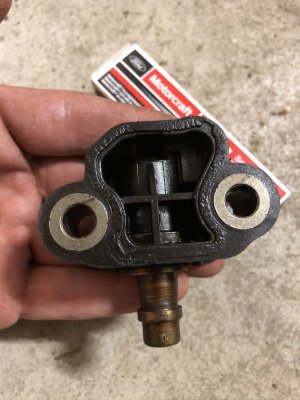

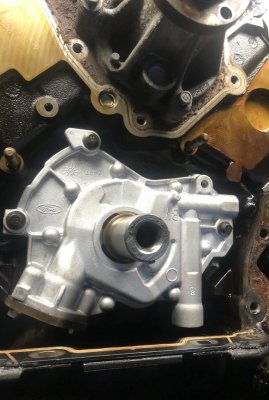

I have talked to a Ford technician about the phasers and he said it’s the exact same problem between the 3-valve Triton V8 engines and the DOHC engines like the EcoBoost. They only differ in what causes the problem to occur. For both it is wear or breakage of the locking pin in the sprocket mechanism. On the 5.4 the primary cause is low oil pressure to the phaser (which is caused by chain tensioner gasket blowouts). I opened up my 5.4 3V and did the timing chain tensioners, guides, and put in a brand new Ford 3V oil pump this April during quarantine. I had the startup rattle but no phaser knocking yet, and I didn’t want to play with fire later on. On the 5.4 this wear on the pin is a warning to address because this low pressure will slowly lead to further damage in the heads. You want to get your stock level oil pressure back. I don’t know how the EcoBoost is setup but I believe the phasers are NOT oil pressure driven like the 5.4 so the damage is occurring for some other reason. Hopefully not as crucial. Here was my startup rattle, this little gasket bleeds off pressure and relaxes the chains. And the new “heart”. I like the analogy of a heart for the oil pump, since it pumps the oil and keeps your engine alive lol.
