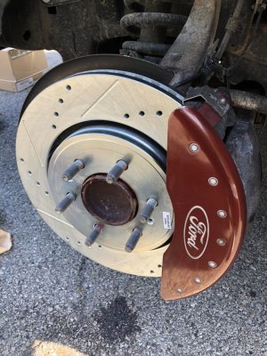

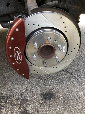

I did power stop rotors cross/drill front and rear rotors with autozone ceramic gold pads, no issue
Those are things of beauty! The RockAuto price is $415...about $520 with shipping and tax. If I was gonna keep the car for 5-6 years I'd go for them, but a decent less expensive set will do. Thing is I'm not finding anything that specifies "best for towing" other than the RockAuto listing for the Powerstop Z-36s.
