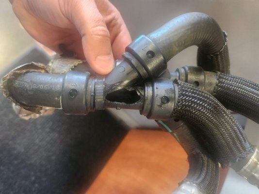

That plastic coolant junction was struck by something, which caused the broken section. Think a socket wrench handle end.
This. That plastic junction is no way the weakest point in the system to fail like that. A connection will likely fail or uncouple before that part would burst in that manner. VERY SUSPECT. Most warranties don't cover coolant hoses because right hoses dry out and leak over time but I'd argue this is NOT wear and tear and not a "hose."

Those hoses failed on my Wife's 18 about a month ago. BUT, they failed at the crimp from rubber to plastic - not at that joint. That definitely looks like it was struck by something. I paid less than $100 for both hoses and replaced them myself. Process sucked a bit since it's tight, but since it's a part that's not covered by the extended warranty, I had to bite the bullet. I'd probably try to at least get the cost of the part waived...

Similar heater hose broke on my wife's '11 and. I cut out the Y, replaced it with one from the parts store. The part and clamps cost under $10

One of those hoses on our 2018 had a slow leak at a connector around 75k miles. Dealer replaced both, think the cost was about $450 if I recall properly.
Repair not covered my ESP.
