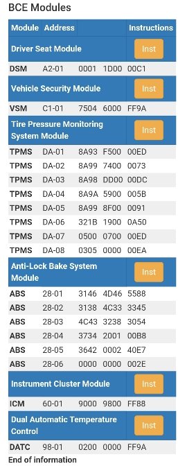

Here's the as built data of a 2003 Eddie Bower. Looks like your getting all the modules.
We'll work with what's available. It sounds like a fun project d1750410cceff82d75dafb3e7933eaae.jpg
Update, here's a clue. We should be looking into the instrument cluster module.
Can you post your ICM AS built line? It starts with 60-01 like above.

From my recollection, changing the second block from 1800 to 1200 is what you want.
I would click the save all button first to make a backup.
I'm checking with another member on the forscan forum for you.
Sent from my SM-N975U using Tapatalk
This worked A+, thanks. You Sir, are the man! - I had searched and posted in the FORScan forum, as well BTW. Couldn't believe there was so much info on how to do this in model years 07+ but not a single breadcrumb for 03-06. Hope this helps someone else out, as well.

Apparently the config can be the following
x8xx - TPMS Enabled
x2xx - TPMS Disabled?
xAxx -?
xExx - TPMS not equipped?

Change the 1800 to 1200 and then click on write.
upload_2020-2-7_17-22-0-png.34287
That will disable the TPMS but will not get rid of the Instrument cluster light. I am still looking for that fix. In the meantime black electrical tape placed over the light will work.
If you change that second block 8 or a 2 to an E that will set the IPC to "Not Equipped with TPMS" and the IPC will never poll the module for the TPMS reading(the non AsBuilt configuration should have a drop down set of options for this too). This is how my 03 Eddie Bauer was set as it did not leave the factory with a TPMS module! If yours has a TPMS module it will still be there in the LH C Pliller under the trim behind the Left Rear door and will still be reading the tire sensors but the warnings will all be turned off!
