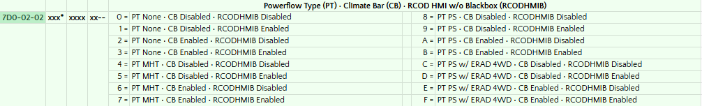

F150 Old APIM 7D0-02-02 5210 00DC 0019
F150 New APIM 7D0-02-02 xxx1 xxxx xx-- (If your current value is 0 then change to 1, 2 change to 3, 4 change to 5, 6 change to 7 Note: reset APIM after the change)
Does anyone know how to accomplish this on the Expedition?

From what I have seen, if the vehicle is on Sync 4, the APIM config is pretty much the same across all Fords. Once you start getting into the BCM, IPMA and other modules, things can start to get very different across different vehicle platforms. Removing the black box works for every vehicle on Sync 4 the same way from that I seen on several forums including the Bronco Sport which also has little to no FORScan support.
You cannot brick anything by changing bits of config to try and enable/disable something. The only way you can brick a module is if you are writing firmware to it and something goes wrong in the process. The word "bricking" gets tossed around with FORScan a lot, but it is actually quite difficult to brick a module. As long as you make back-ups or document what changes you make, you can always revert back to where you started from if the changes you make yield an undesired result.
I pulled the config off of a random 2025 Expo. It shows this in that line of the APIM:
A 2 there means rear camera on demand w/o blackbox is disabled. So it would need to be changed to a 3 so that powerflow type and climate bar remain unchanged, but you enable RCOD without blackbox instead of with blackbox.
